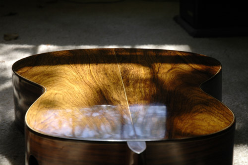

Okay, here's a purposefully bad photograph, intended to show the gloss. I started this back at 9:30 last night, and went until I pooped out. I don't know, maybe 1 1/2 -2 hours? Anyway, the back is not finished because I ran out of time, so I need to do a bit of level sanding, and then do a bit more build and then spirit it off. But, this is what you can accomplish in a few hours of work.
rlabbe38524.3989583333
PostPosted: Tue Jun 21, 2005 2:44 am
Posts: 1157
Location: Siloam Springs, AR
That's very cool, Roger. Can't wait to take the class.
